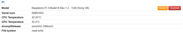

Raspberry Pi 5 with image emonSD-01Feb24 menu item Admin/System Information/PI and the Reboot, Shutdown buttons are missing
Raspberry Pi 5 with image emonSD-01Feb24.zip 32-bit Based on Raspberry Pi OS Lite (32-bit Bookworm) I noticed that the menu item Admin/System Information/PI and the Reboot, Shutdown buttons are missing.
This is how it looks on my Raspberry Pi 3, on the Raspberry Pi 5 this item is completely missing.
grafik
I am aware that the Raspberry Pi 5 is not officially supported yet, an installation with EmonScripts emoncms installation script caused the same problem.

  • emonhub :- Active Running
  • emoncms_mqtt :- Active Running
  • feedwriter :- Active Running - sleep 300s 1041 feed points pending write
  • service-runner :- Active Running
  • redis-server :- Active Running
  • mosquitto :- Active Running
  • emonPiLCD :- Inactive loaded inactive dead
  • emoncms_sync :- Inactive loaded inactive dead
  • demandshaper :- Not found or not installed
